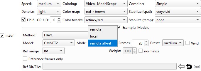

RE: Deoldify Vapoursynth filter - Selur - 26.04.2026 Uploaded an updated Hybrid_havc_test, where I adjusted the defaults. Cu Selur RE: Deoldify Vapoursynth filter - Dan64 - 26.04.2026 Please remove "remote all-ref" both from CMNET2 and ColorMNet. Thanks, Dan RE: Deoldify Vapoursynth filter - Selur - 26.04.2026 Uploaded an updated Hybrid_havc_test, where I removed the option. (since that option is only used for CMNET2 and ColorMNet, I could simply remove the list entry. Cu Selur RE: Deoldify Vapoursynth filter - Dan64 - 26.04.2026 Now It's Okay. I will probably release HAVC v5.8.0 next week. There is still a lot of work to be done on documentation side. Thanks, Dan RE: Deoldify Vapoursynth filter - Selur - 26.04.2026 Nice!
