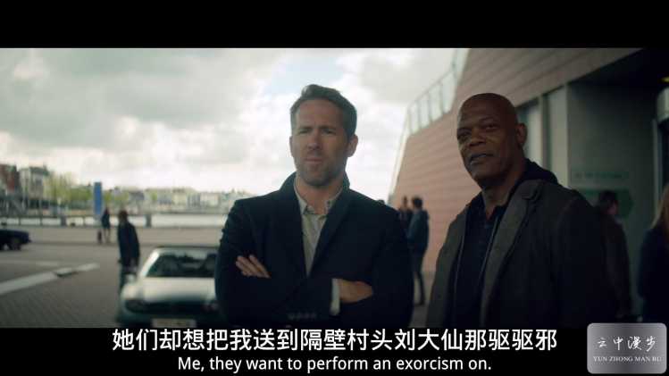

how to upscale and encode ass subtitle at the same time? - i990049 - 27.03.2021 The original file is 1920*804, and I want to upscale to 1920*1080 like this picture, and encode the ass subtitle out of movie screen at the same time. Please tell me how to do it, thanks. RE: how to upscale and encode ass subtitle at the same time? - Selur - 27.03.2021 Quote:I want to upscale to 1920*1080 like this picture,Add borders by:
Quote: and encode the ass subtitle out of movie screen at the same timeAssuming you want to embed / hard-code the subtitle:
Cu Selur RE: how to upscale and encode ass subtitle at the same time? - i990049 - 13.10.2021 (27.03.2021, 17:38)Selur Wrote:Quote:I want to upscale to 1920*1080 like this picture,Add borders by: I tried several times,upscale is ok.But embed subtitle at the same time failed.I use x 264 crf mode.Do i have to encode again just for embeding subtitle?Is it possible upscaling and embed subtitle at the same time? RE: how to upscale and encode ass subtitle at the same time? - Selur - 13.10.2021 Without a debug output I can't tell what you are doing wrong. Yes, scaling and embedding can be done at the same time. If you do, you might want to check the 'Vapoursynth Preview' assuming you use Vapoursynth, to be sure the Subtitles have the correct height, etc. . Depending on the scaling of your subtitles you might want to move the 'AddingSubtitle'- before (or after; which is the default) the 'Resize'-filter under 'Filtering->Vapoursynth->Misc->Filter Order/Queue'. Cu Selur |
