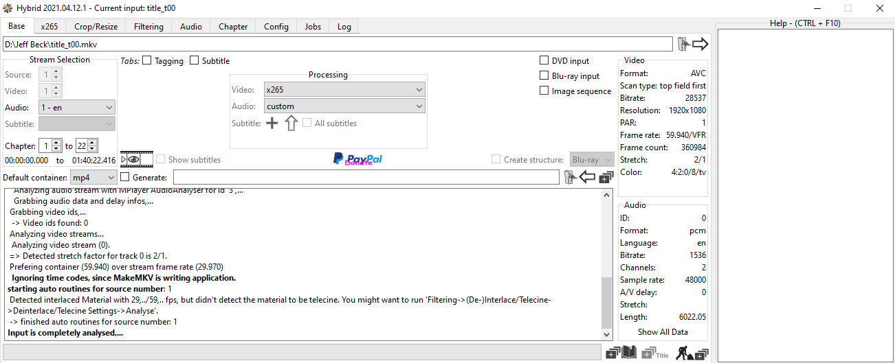

I've got a problem with a mkv file made with makemkv. Hybrid load it like 59.940 fps instead of 29.970 and i get a file at double speed. If I use a bob deinterlaced I get 119 fps.

Here is the debug output.
RE: Double framerate - Selur - 03.06.2021
MediaInfo reports:
Frame rate mode : VFR Frame rate mode : Variable Frame rate : 59.940 Frame rate : 59.940 (60000/1001) FPS FrameRate_Num : 60000 FrameRate_Den : 1001 Original frame rate : 29.970 Original frame rate : 29.970 (30000/1001) FPS FrameRate_Original_Num : 30000 FrameRate_Original_Den : 1001 Frame count : 360984 Standard : NTSC Color space : YUV Chroma subsampling : 4:2:0 Chroma subsampling : 4:2:0 Bit depth : 8 Bit depth : 8 bits Scan type : Interlaced Scan type : Interlaced Scan type, store method : SeparatedFields Scan type, store method : Separated fields Scan order : TFF Scan order : Top Field First
-> try whether it helps to enable: "Config->Internals->Prefer Original->Frame rate" before loading the source
RE: Double framerate - ojete - 04.06.2021
Now it works. So it's a problem of the source.
