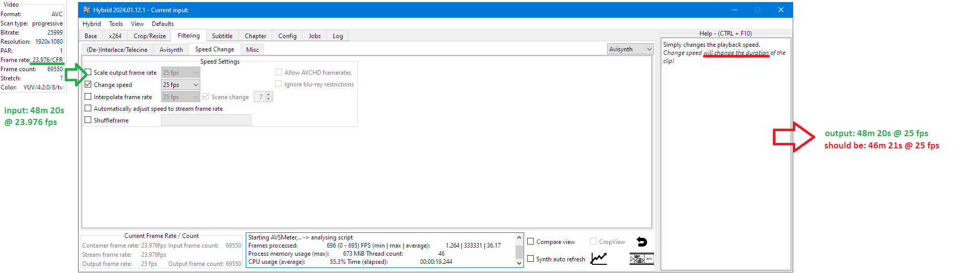

Could you please tell me what I did wrong? Input mkv @ 23.976 fps, output mkv @ 25 fps, but length of the video is not changed (should be shorter):
Hybrid debug log in attachment. Using the latest version 2024.01.12.1 with clean install. Changing between avisynth / vapoursynth not helping.
Thanks!

'Change speed' should just change the flags of the container (and if possible stream) since neither Avisynth nor Vapoursynth are used it's no surprise that switching between them does not change anything.
the problem is with the decoder call:
ffmpeg -y -loglevel fatal -noautorotate -nostdin -hwaccel auto -threads 1 -i "1.mkv" -map 0:0 -an -sn -vf scale=1280:720,fps=25/1,scale=in_range=tv:out_range=tv -pix_fmt yuv420p -vsync 0 -sws_flags spline -f rawvideo -
then fps=25/1 part is wrong, this should be "fps=24000/1001".
=> Looking into it.
