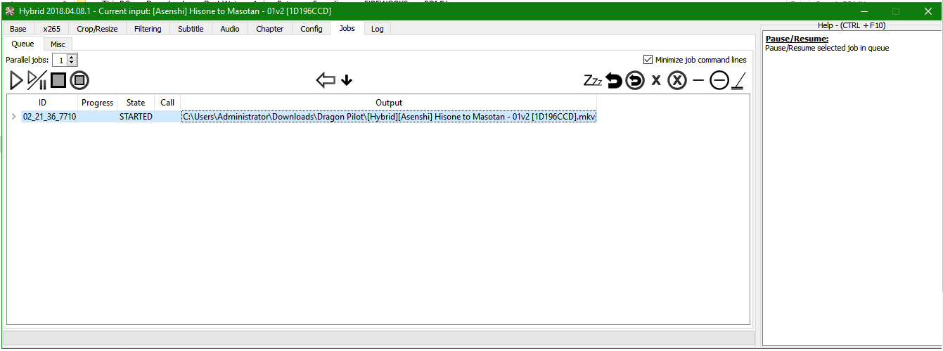

Hello, I'm using Hybrid 2018.04.08.1 on a Windows 10 64-bit PC.
This happens every time I try to re-encode something from a 10-bit x264 source to 10-bit x265.
While encoding from an 8-bit x264 source, Hybrid uses ffmpeg.exe and x265.exe and the encode completes normally.
But while encoding from a 10-bit source, Hybrid uses avs2yuv.exe instead of ffmpeg.exe.
And every time, the progress bar abruptly halts at some random percentage (eg. 13.6% or 45.5% or something) and doesn't progress any further. It gets stuck there with the job detail still saying "started" and no error message. It doesn't progress any further even if I leave it untouched overnight. There is no error message.
This used to happen with every 10-bit x264 source file on my own system. But now I'm using Hybrid on an RDP server (Windows Server 64-bit), and the same problem occurs there too. It abruptly gets stuck and doesn't progress anymore.
What could be causing the problem?
Can you please suggest some fix?

RE: Progress stuck while using avs2yuv - DashWatson - 20.04.2018
The processing started at 02:21:36 and at about 02:40, it got stuck at 18.70% and hasn't moved for the last 15-20 minutes. Process priority was above normal and it was using 100% of the CPU with no other tasks running in the background. Debug file wasn't growing when the job was stuck.
After 40 minutes, I got tired of waiting any more and paused the job.
Then I resumed it, but the progress bar isn't showing anything anymore.
No other changes after that, in Hybrid or in the debug file.
However, avs2yuv.exe is still using up 25% of the CPU while everything is stuck.
But x265.exe is using 0% CPU.
I don't understand if the problem is with avs2yuv or x265, because while encoding from an 8-bit source using FFMS2, FFVideoSource, ffmpeg.exe and x265.exe, everything works fine and the encodes complete normally.
