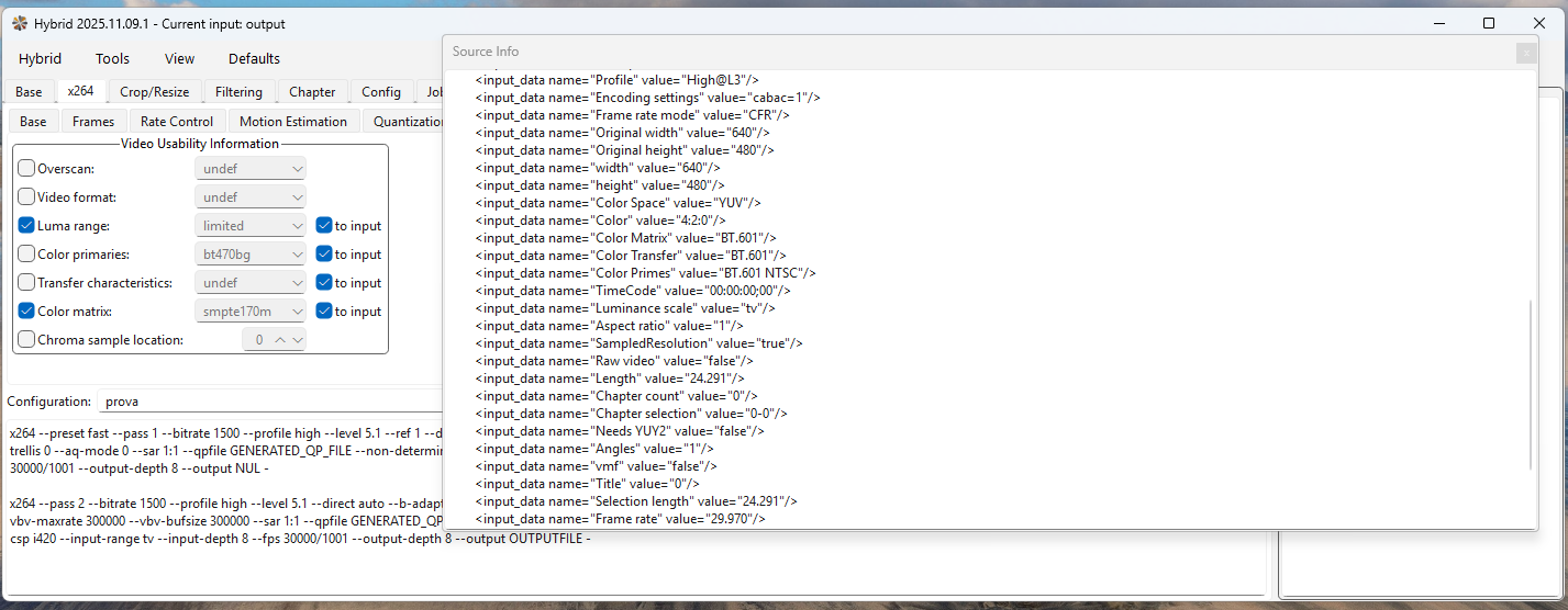

RE: Change input color - Doom83 - 25.02.2026
Dont know why i have file bt601 in primaries, transfer and matrix but hybrid dont recognize and put bt470bg and unknow  Huh
RE: Change input color - Selur - 25.02.2026
You can read the debug output and see where Hybrid comes up with the value,...
I suspect, x264 doesn't support the values of your source and Hybrid tries to use something similar,..
this is what x264 supports:
--colorprim <string> Specify color primaries ["undef"] - undef, bt709, bt470m, bt470bg, smpte170m, smpte240m, film, bt2020, smpte428, smpte431, smpte432 --transfer <string> Specify transfer characteristics ["undef"] - undef, bt709, bt470m, bt470bg, smpte170m, smpte240m, linear, log100, log316, iec61966-2-4, bt1361e, iec61966-2-1, bt2020-10, bt2020-12, smpte2084, smpte428, arib-std-b67 --colormatrix <string> Specify color matrix setting ["???"] - undef, bt709, fcc, bt470bg, smpte170m, smpte240m, GBR, YCgCo, bt2020nc, bt2020c, smpte2085, chroma-derived-nc, chroma-derived-c, ICtCp
see: x264 --fullhelp
Ps.: alternatively share a sample with these characteristics and I can look at it over the weekend.
I use that code in ffmpeg for create che file
ffmpeg -i 01.asf -vf "scale=640:480:flags=lanczos,setsar=1" -map_metadata -1 -c:v libx264 -crf 18 -preset slow -color_primaries smpte170m -color_trc smpte170m -colorspace smpte170m -color_range tv -c:a aac -b:a 128k output.mkv
become matrix bt601, when i put in hybrid and save, matrix change in bt470bg  Confused
Intervallo colore                      : Limited
Coefficienti matrici                    : BT.470 System B/G
matrix_coefficients_Original            : BT.601
