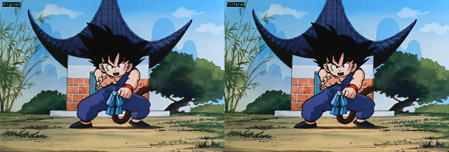

Downscaling by 2.51 and Upscaling using 4x_UltraSharp:
Starting from the DVDs would probably give you better results.
