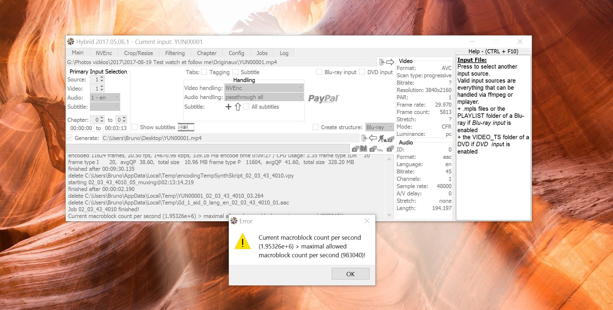

problem NVenc h265 2160p 60fps
Hello, I wanted to test an encoding with NVenc in h265, it works in 1080p and 720p but not with the resolution 2160p . An error message appears "Current macroblock count per second (1.95326e+6) > maximal allowed macroblock count per second (983040)!" (see attached file + debug file). I also convert from 30 to 60fps with vapoursynth at the same time, and if I disable this option, it works ... Is there a solution for this to work in 2160p 60fps?

short answer: Not with your card. That's a hardware limit. Smile
long answer: NVEncC reports the maximum supported macroblocks the VPE chip can handle per second.
For my system 'NVEncC --check-features' reports, with the currently installed drivers:

Note the MAX MB per sec 983040 which indicates that the VPE chip on my card supports, like the one on your card, a maximum of 983040 macroblocks per second.
Hybrid checks this count to avoid creating jobs which will crash due to hardware limitation. Smile
The count of macroblocks per second calculated it self by:
'mbs per second' = 'needed macroblocks for the resolution' * 'frames per second' = ((width / 16.0 + 0.5) * (height / 16.0 + 0.5) ) * fps
=> So all in all, this is a limitation of the Video Processing Engine (VPE) on your card and there is nothing Hybrid or NVEncC can do to circumvent it. The only may to avoid this message and use the resolution and fps you selected with a vpe is to use another graphic card that uses a vpe that isn't that restricted. Smile
