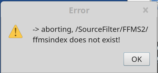

But now I tried the Hybrid VS preview again and got a popup:
I suppose this is not a file system URL, but I definitely have no ffmsindex on my system, there is only the ffms2.so library. Is there still something missing in the installation?
