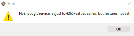

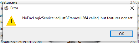

old version re-installed, tools clean, install latest version ; It starts one time...
Errors pop ups again when i starts it next times

Okay, seems like Hybrid still finds your card, even when it looks again for it.
Hybrid looks for the card in:
HKEY_LOCAL_MACHINE\\SYSTEM\\CurrentControlSet\\Control\\Video\\Device Description
HKEY_LOCAL_MACHINE\\SYSTEM\\CurrentControlSet\\Control\\Video\\DeviceDesc
HKEY_LOCAL_MACHINE\\SYSTEM\\CurrentControlSet\\Control\\Video\\DriverDesc
if it finds an NVIDIA cards there it's try NVEncC.
So clearing the registry properly should help.
You could also disable the search for NVIDIA cards using 'nonvidia=true' in your misc.ini, see:
[INFO] *hidden* Hybrid options,...

(19.06.2019, 20:22)Selur Wrote: Okay, seems like Hybrid still finds your card, even when it looks again for it.
You could also disable the search for NVIDIA cards usingĀ 'nonvidia=true' in your misc.ini, see:
YES ! removed registry key refering to my nvidia card ; now hybrid starts correctly.
Thanks a lot again !
