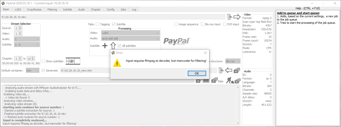

Does the application show the following error when cropping the movie! Why?
Input requires ffmpeg as decoder, but mencoder for filtering!

Really strange, can't reproduce this here either.
Loaded a source with interlaced mpeg-2 inside a mkv, used 'QTGMC (Avisynth)' and 'QTGMC (Vapoursynth)' in both cases no problem.
Without details a
-> create a debug output level 9 or the job creation, this should include the reason why Hybrid thinks that ffmpeg is needed for the input but mencoder for filtering.

It happened when crop top and crop bottom size isn't equal!
for example:
crop top=10
crop bottom=12
#14
will look into it
#15
Think I found and fixed the bug in the job creation checks, will send you a PM with a link to a dev version for testing in a few minutes.
