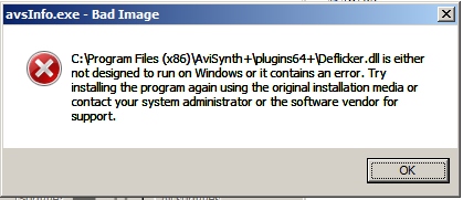

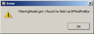

Dragged avs script to load it, and got these: (attached)
Dragged the test avs, and it did the same.

Nope, newest dev is the same. Where did that even come from? It was fine on my 1st test! Grr... Sad

Which now alarms me ... why is Hybrid dipping into my "C:\Program Files (x86)\AviSynth+" folder??? Because I definitely don't want Hybrid to mess up my system wide Avisynth. Did Hybrid add or change anything at that folder? avsInfo still crashes. So now I must ask ... is that something within Hybrid, or is it pulling from elsewhere on my system? Though I don't believe that I have avsInfo anywhere, so assuming from within Hybrid folders.

Without a debug output my only guess is that avsInfo 32bit is used for a 64bit script or avsInfo 64bit is used for a 32bit script or something is wrong with the script.

Hybrid should update the avsInfo used depending on the "Avisynth type" setting,...
Would need a debug output to be sure what's happening.

The avsInfo error happens with I drag the avs script into Open File on the Base tab. I just click "Close the program" and keep working. It seems to work fine?
