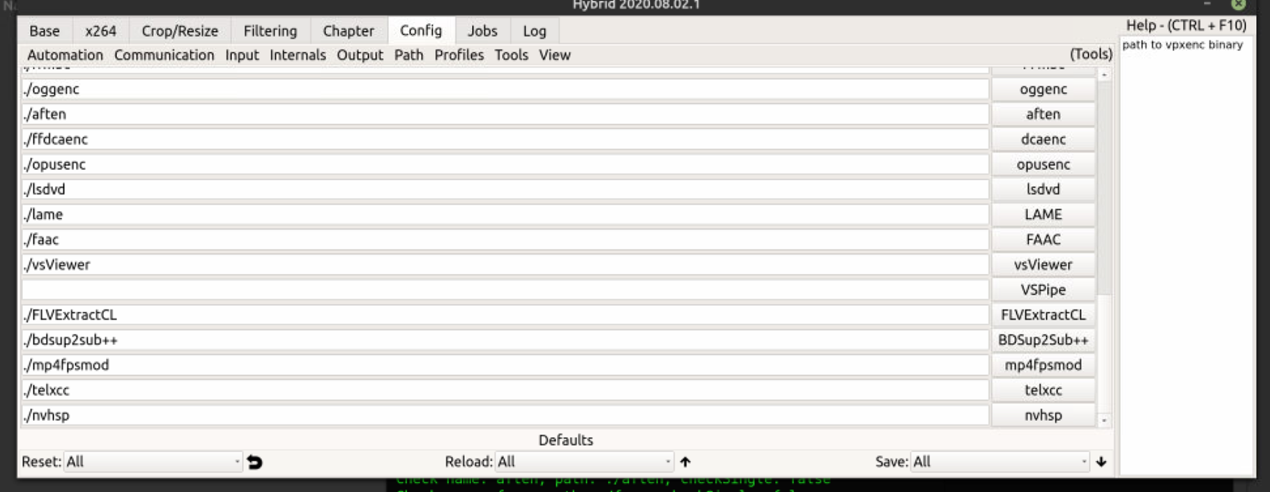

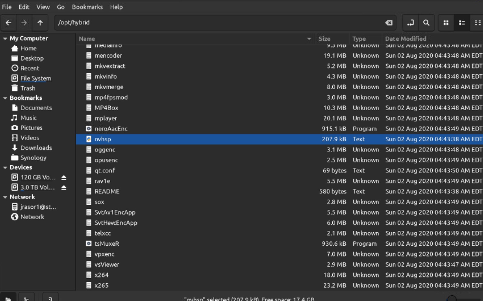

Woah totally didn't see the 'add attachment' button when I made this post. I'm currently using Linux Mint 20 with the most current 450 Nvidia Drivers. I have attempted to use the 'hdr patch' option to activate nvhsp, however, i keep getting an absolute path error. I have verified that nvhsp is in the hybrid directory. When I click on the nvhsp button on the tool list to pick a different directory, nothing happens like when i click on all the other ones. Will hybrid support NEVencC under linux? I would prefer not to use the mkv advanced signaling as I've read it does not perform the same way.[attachment=958]

The 'set absolute paths crashed,...' is strange seems like Hybrid doesn't know where to find nvhsp.
Does "Config->Tools" show the path to nvhsp ?

Yes. When I click on the nvhsp button to try to select a different directory (a downloaded copy of nvhsp) nothing happens, it doesn't bring up the open directory window like the rest of the tools do.
