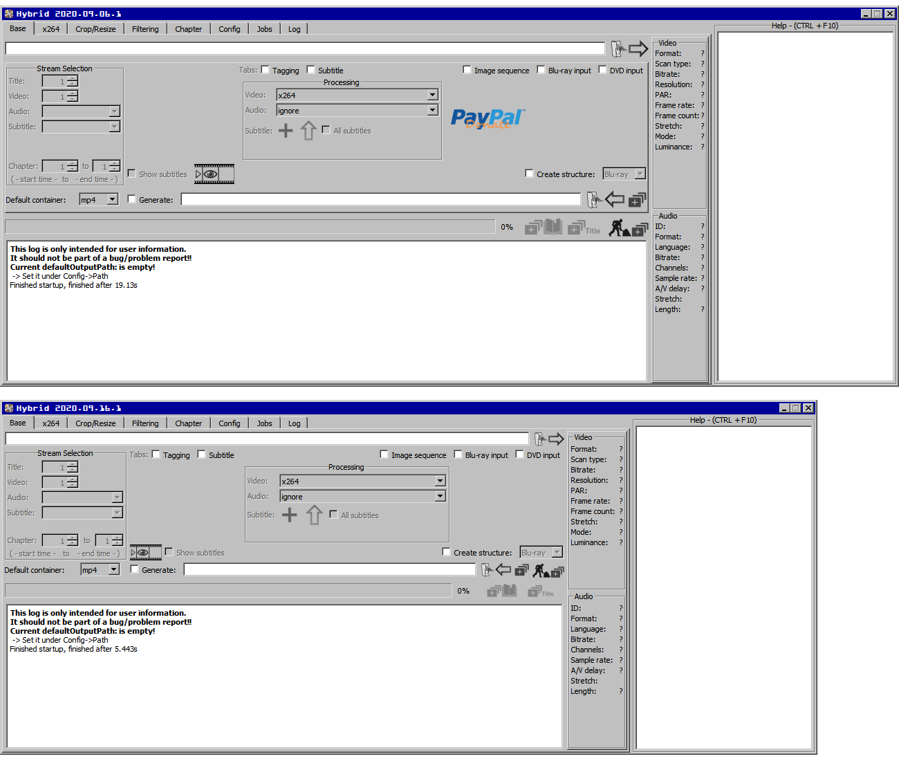

ALSO, the Hybrid window size in this version is too small! Tongue
Previous release was 1300x551, this release is 1182x513:
Will fix the quote-problem and send you a new test link in a few minutes.
Size is changing since I'm testing around with icon sizes and scaling,.. Wink
