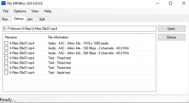

1) I used "My MP4Box GUI" to extract the subtitles (see attached image)
2) I used MKVtoolnix GUI to convert the mp4 container in mkv. For some reason also this tool is unable to get the subtitles (but this is an old problem), so I had to add the subtitles extracted previously with "My MP4Box GUI"
