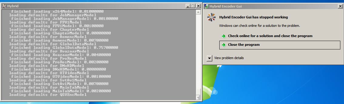

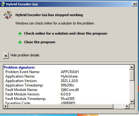

#13
Hybrid starts without a problem using your settings,... :/
I compiled a version which shows some output during startup in a command line window.
Extract the attached version and replace the Hybrid.exe with it and try whether it starts up or if it shows at which point Hybrid crashes,..
#14
Replaced Hybrid.exe
#15
Okay, seems to be an issue with QSVEnc which isn't called on my system since I have an AMD cpu.
