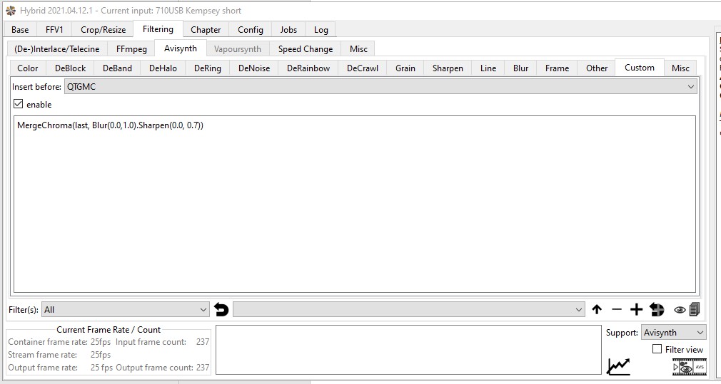

I'm trying to run a short AVISynth script before QTGMC but I'm getting a "video crashed ERROR C" message and "avi was not created".

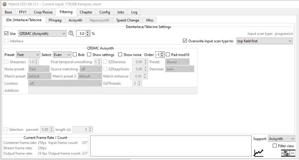

Here are the screenshots of my Hybrid setup.

It's a bug with the CustomQTGMC addition using another value than QTGMC as 'Insert before' should work. Smile
-> will look into it and send you a link to fixed version.
