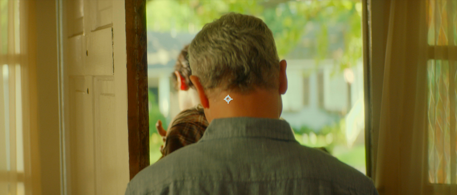

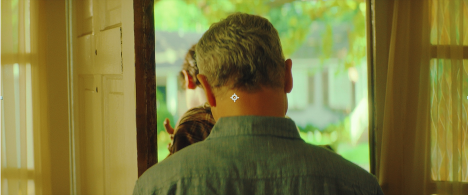

The After Effect there are two parameters, saturation and vibrance, they don't work the same way (I set the same filling parameters for each option). In Hybrid there is the ability to change the saturation, but this parameter does not do what I need, I need how the vibrance parameter does. Is there a vibrance parameter in a Hybrid?
![[Image: Brightnes.jpg]](https://i.ibb.co/3kg1CZ2/Brightnes.jpg)
