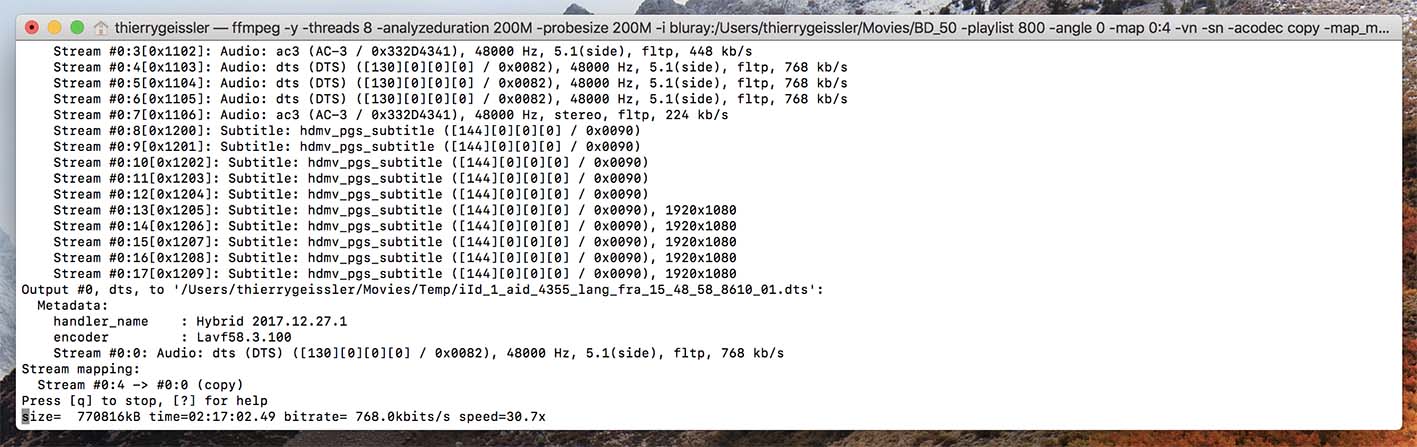

Hello
now the analysis works, the extraction of the subtitles too, but after the extraction of the audio the program stops at 99% and after the 1st pass of the video compression also at 99%
DoZer
Without a debug output and or details, I have no clue what you are doing and what is nor working on your system,..
