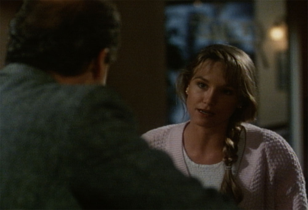

Here is a frame grab from the TIVCT output, with no de-noise filtering. As you can see, it is rather noisy and a bit murky in general. Probably due to it being from an old 1980s telecine.
Any suggestions how to remove some of the noise?
Just from the screenshots it mostly looks like blocking artifacts, so a deblocker is probably what you want to use.
You probably need to use higher than the default values and test a bit to find a setting that a. removed the blocking and b. doesn't kill too much details in the process. You probably also might want to apply some sharpening after the deblocking.

It's a digitised master from an analogue tape master of a 1980s telecine. Would those DVD settings still work?
(05.08.2021, 14:44)Selur Wrote: Just from the screenshots it mostly looks like blocking artifacts, so a deblocker is probably what you want to use.
[Image: deblock-sharpen.png]
Which de-block settings did you use? Those in De-Interlace/TIVTC or those under filtering?
