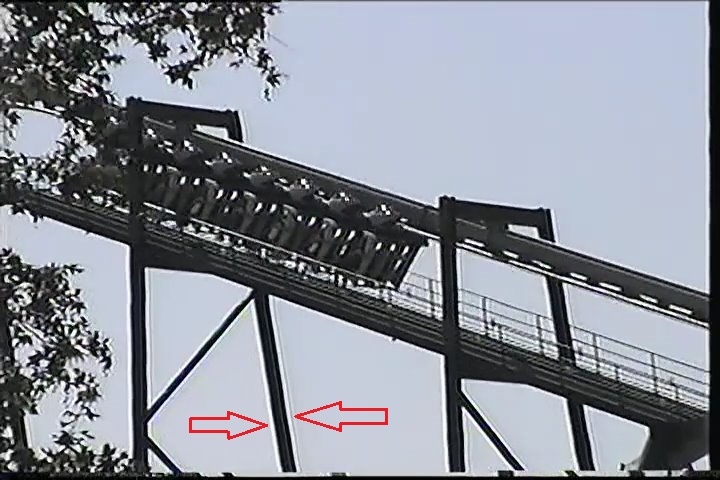

I'm glad to have found this topic.  I need some guidance on this subject.  Source is analog VHS-C tape.  Attached is a short clip and image capture
Is this Halo?  It effect both sides of the column.
If it is Halo, what DeHalo settings do you recommend to use?
If I have several tapes from the same camcoder, will a single setting apply to all tapes or it is different for each scene?
I do not recommend using this source.
Looks like some capture where tons of sharpening was applied, that caused ringing and halos, so I would re-capture it. (and turn that damn sharpening off)
I would probably start with some masked aWarpsharpen + DeHalo_alpha +Santiag + DPIR
image: https://imgsli.com/Mjc3MjE3
script: https://pastebin.com/96gpQKUb
the values are used need to be tweaked.
