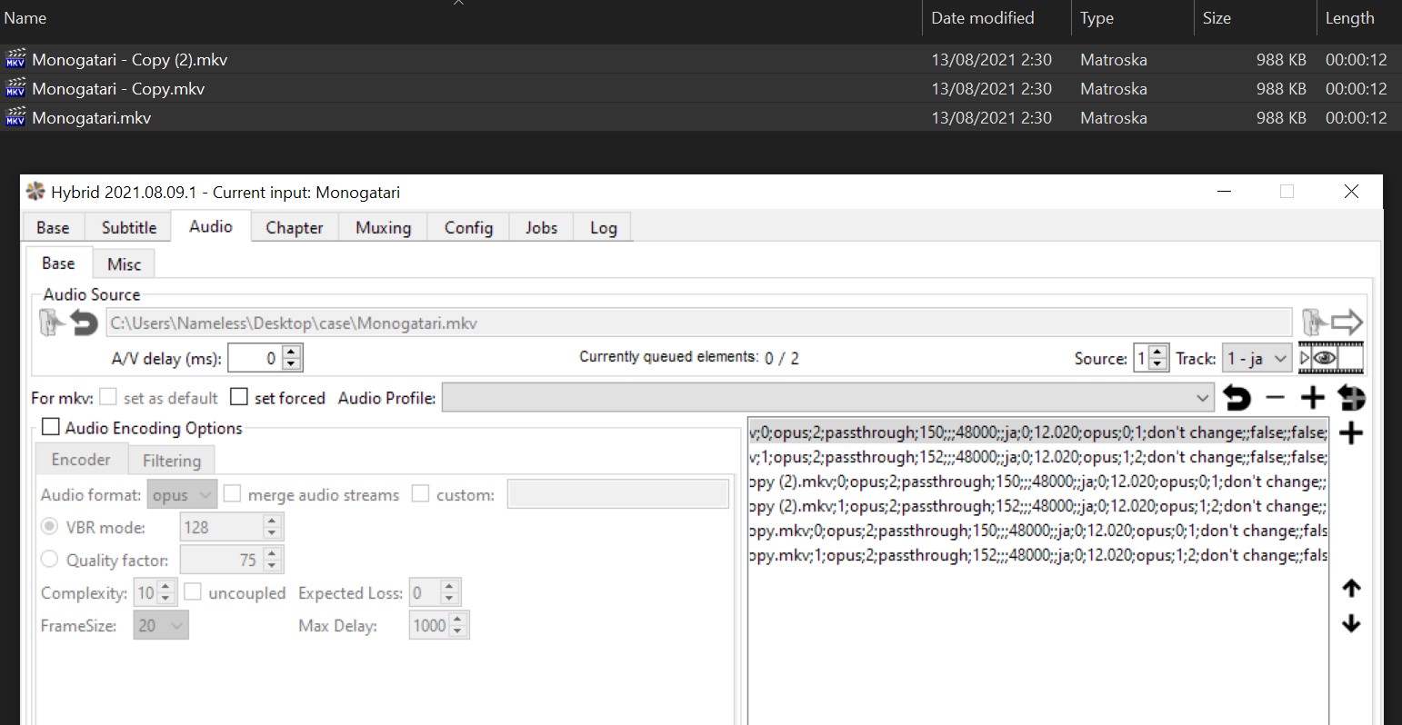

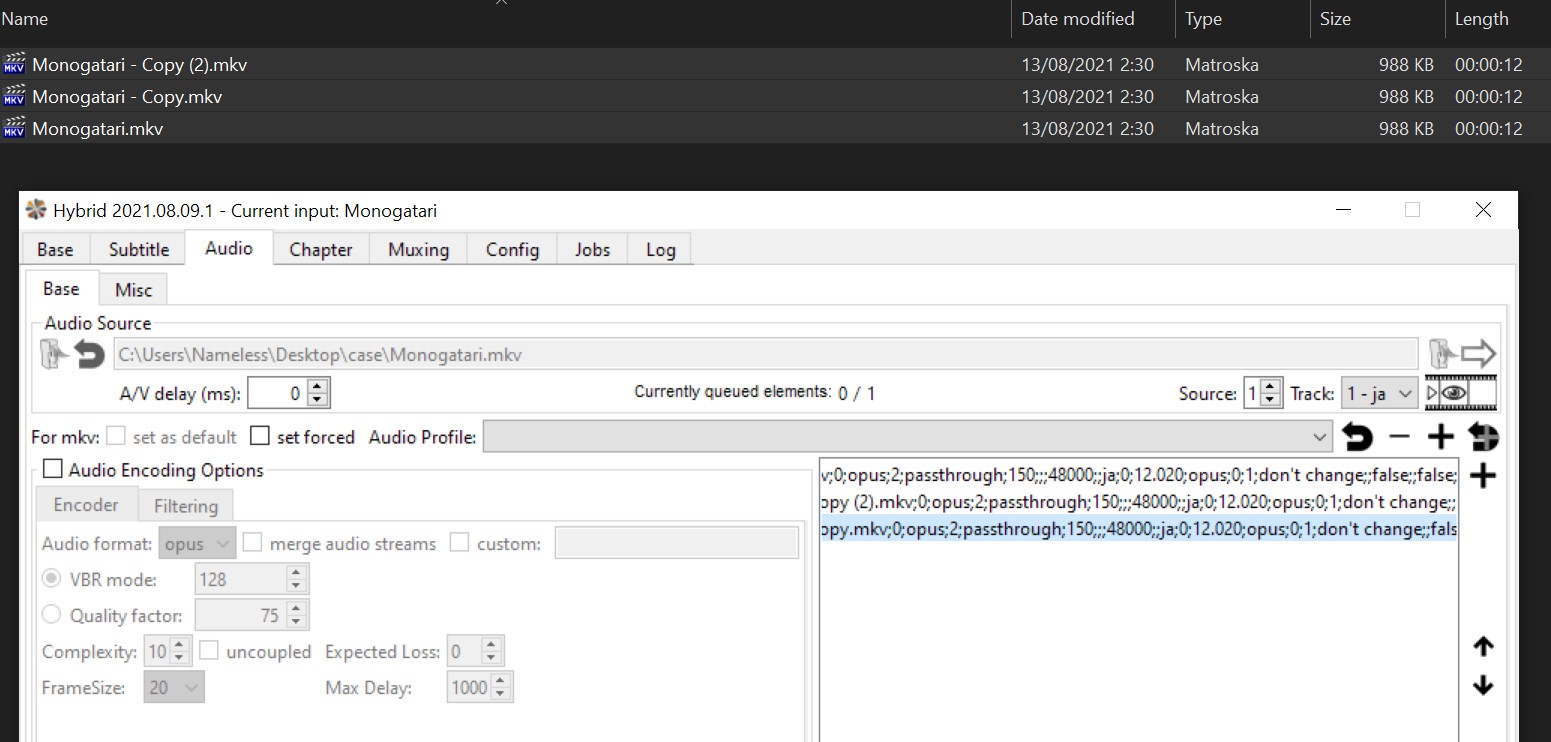

Was running things in passthrough to get rid of the commentary tracks and came across another weird one where it ignores changes after the first job of a batch queued up?
To repeat it on my system:
Cut down sample to only have the video & audio + comments [attachment=1500]
then make a few copies of the file
remove the comment tracks

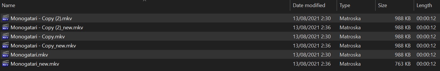

As can be seen with the filesizes, only the first job in the queue (Monogatari.mkv) removed did anything (Monogatari_new.mkv)
I haven't got a clue about this one.

What? I don't get at all what I could do to reproduce the issue, since I don't get what the issue is.
Screenshots do not help at all.
Wild gues is that you did use 'Base->Processing->Audio->auto add (all)', then adjusted the audio queue without changing 'Base->Processing->Audio' to custom and Hybrid changed the audio queue afterwards,...

(13.08.2021, 04:42)Selur Wrote: Wild guess is that you did use 'Base->Processing->Audio->auto add (all)', then adjusted the audio queue without changing 'Base->Processing->Audio' to custom and Hybrid changed the audio queue afterwards,...
Close, I think? after reading the mouse-overs I think I see the issue...
I'd always ASSumed that the base-> audio dropdown was just how Hybrid handled populating the audio job list when it was fed input file(s) and that was as far as it went.
It would make a lot more sense if this was how it operated...
This situation where "auto add" only applies changes to the first job file then silently ignores any other changes to the audio queue of any following jobs is inconsistent and unintuitive, having to change the base->audio tab to custom to get the edits to the audio job queue to stick is also convoluted.
