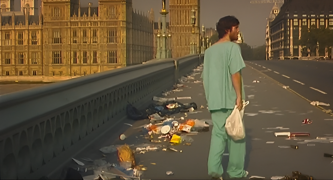

To test the model I downsized a short movie (20s) to the resolution of 640x346 (ratio 1.85:1) and then I resized it to 1920x1040.
This is the image resized with Lanczos4
[Image: Video-Test-640px-Lanczos-25.png]
This is image is very near to the source (fake Blu-Ray) since I used for testing a clip of the movie "28 Days Later" that was filmed using a Canon XL-1s standard-definition camcorder at 720x576 resolution and probably the Blu-Ray was obtain by up-scaling with Lanczos (or something similar) the original movie.
The following picture was obtained using RealSR included in Hybrid
[Image: Video-Test-640px-Real-SR-25.png]
And finally this is the picture obtained using realesrgan-x4plus
[Image: Video-Test-640px-Real-Esrgan-25.png]
As it is possible to see it is not necessary to perform 4x zoom to observe the details, the difference is very clear and the up-scaled image with realesrgan-x4plus contains more details than the original movie.
