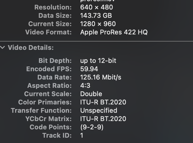

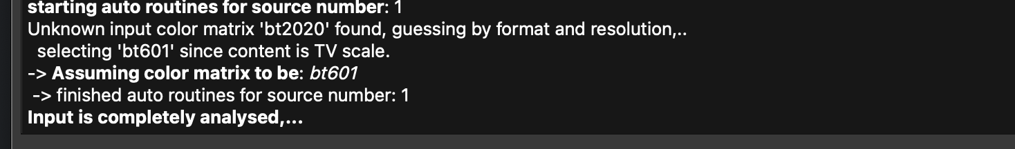

Attached is a screenshot of its data when I open the prores file in QuickTime and open movie inspector, and also a screenshot of the hybrid screen right after I open the file in Hybrid.  The file was exported from Davinci as prores with a 2020 color matrix.  I am using Hybrid 2021.07.18.1 and I am just trying to save the prores file as 10bit h264.

Ps.: as a side note: it's not about Hybrid chaning the flag, it's about Hybrid either not properly detecting or handling the flag.

That debug output is useless as it only includes the job processing which is useless in your case.
Analysis an job creation are important.
I send you a link (via pm) to my current dev version which might already fix the issue.
In case it does not, create a debug output of the analysis of the source and the job creation, not the processing of the jobs, with that version.

That might have done it!  When I load the file in that version the initial scan doesn't say that it changed it to 601.  I will run the file now and check it at the end.  thanks!
