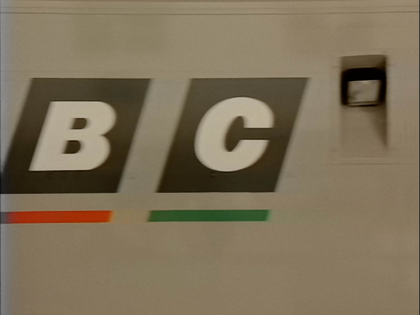

I've tried most of the rainbow and chroma noise reduction filters but none of them seem to remove the rainbowing on a very old U-matic TV master. Any suggestions?
Would need a small video sample to suggest anything, since those artifacts are usually changing over time.
Latest dev versions
A few suggestions to start with:
'Temporal Degrain' + 'CAS'
[Image: Basic-VSR-CAS.png]
'MLDegrain' + 'CAS'
[Image: MLDegrain-CAS.png]
Basically any of the DeGrain filters seems to work fine and remove most of the chroma artifacts on default setting, increasing filteirng for chroma will probably do more, or on could try some ml based filters.
BasicVSR++(required torchAddon)
[Image: Basic-VSR.png]
BasicVSR++(required torchAddon) + GrainFactory3
[Image: Basic-VSR-Grainfacotry3.png]
If it's mainly about the chroma noise, try for example HQDN3D and increase the spatial and temporal chroma strength.
Hqdn3d(clip=clip, lum_spac=0.00, chrom_spac=7.00, chrom_tmp=10.50):
[Image: Hqdn3d-clip-clip-lum-spac-0-00-chrom-spa...-10-50.png]

Thank you, I will try Smile
Thanks, HQDN3 works very well. I also need to upscale to 1080p.
