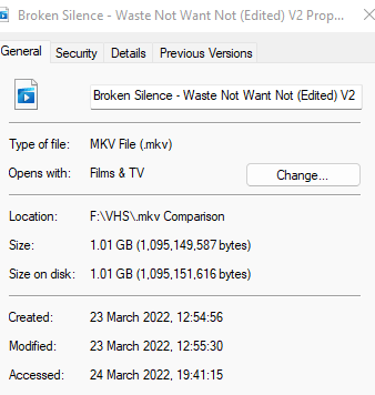

The video was originally 25fps. So you saying it not normal for 50fps video to be bigger than 60fps video? I did made one 50fps video that was downsized to just 1GB but I'm not sure what settings I used for it. What kind of details you want to know?

I somehow made one .mkv job with the same video down to 1GB but I can't remember how I done it, I posted the debug below based on the time it was created. (I have previously posted this debug output on here, where I thought it had no sound, when it actually did)
#19
On that encode you used:
# deinterlacing ConvertToYV12(interlaced=true) Yadif() # adjusting frame rate SalFPS3(60.0) # cropping Crop(8,0,-8,0)# 704x576 # filtering # scaling to 1440x1178 LanczosResize(1440,1178)
so you:
  • threw away part of the color info (422->420)
  • used Yadif and prodced 25fps
  • used SalFPS3 to go from 25 to 50fps
  • cropped
  • resized
Quote:Correct. So InterFrame is the culprit for reducing the file size despite having more frames? I take it that isn't exactly a bad thing?
That depends. If your output is 4:2:0 than it will occur somewhere along the line so no harm.
If your output should be 4:2:2, throwing away a good protion of the data might not be good thing.
-> Comparing the size of lossless outputs with different color samplings makes no sense.
Comparing the size of lossless outputs and different interpolations without looking at the actual content makes no sense.
