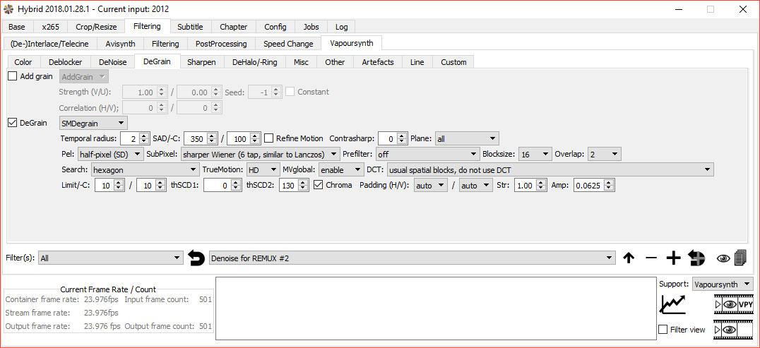

SMDeGrain Crash.
When using DeGrain, Hybrid can not encode the movie and the following error is given.
Creating job for current source
-> Creating jobs for source 1,...
-> Generating calls for: C:\Users\Mohammad\Desktop\test.mkv
 adding x265 calls for source: 1
 createJobs for C:\Users\Mohammad\Desktop\test.mkv
  creating attachment extraction subjobs
  creating video subjobs
  creating muxing subjobs
  optimizing the subJobs
-> finished creating subjobs for current source
 added new job with id 16_41_36_0110
-> should be there after processing: C:\Users\Mohammad\Desktop\16_41_36_0110_03.265
starting 16_41_36_0110_03_video@16:41:36.461 - C:\Users\Mohammad\Desktop\test.mkv
finished after 00:00:01.154
-> 16_41_36_0110_03_video crashed: ERROR: C:\Users\Mohammad\Desktop\16_41_36_0110_03.265 was not created!
Aborting '16_41_36_0110_03_video' due to: ERROR: C:\Users\Mohammad\Desktop\16_41_36_0110_03.265 was not created!
Job 16_41_36_0110 finished!
Does the Vapoursynth preview report any errors?

Here:

I just activated "high tier" for curiosity.
Here:
