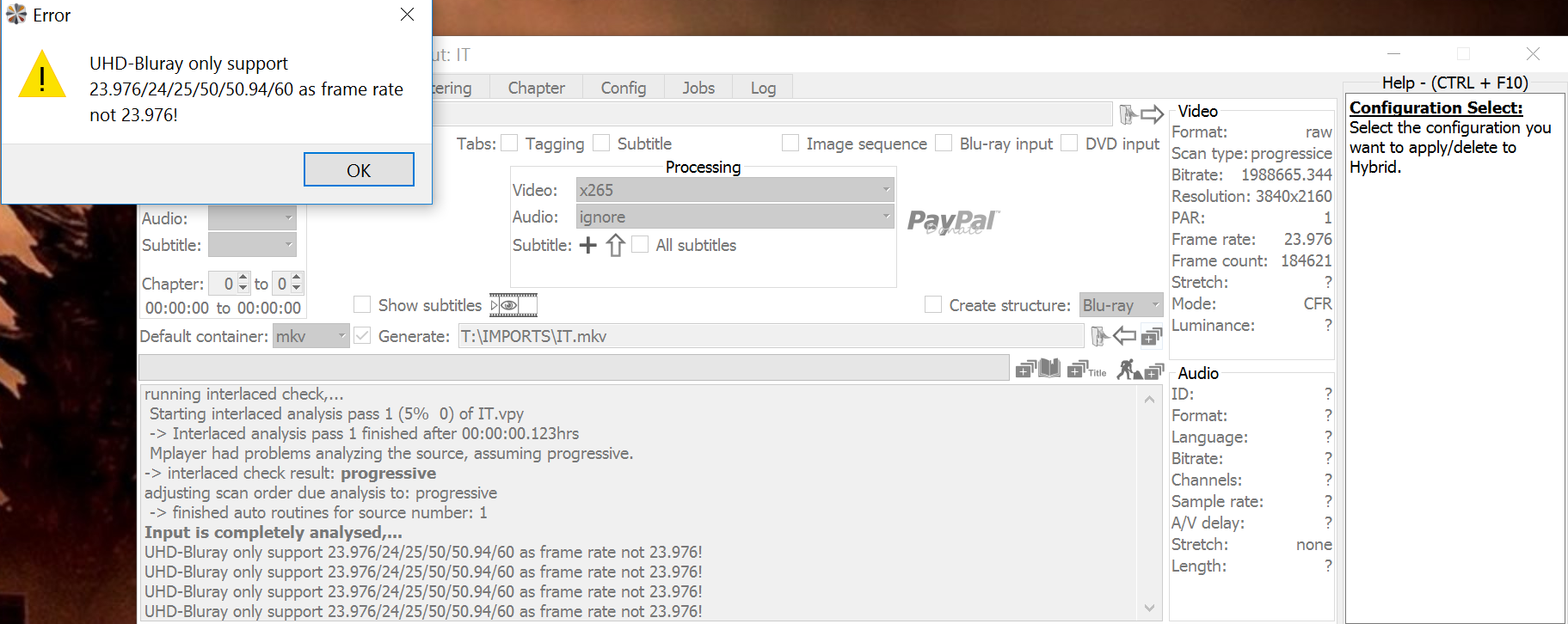

The first issue arises if I utilize the UHD-Bluray button under the x265 menu. I receive two prompts: 1 " Notice: You are muxing a true-hd audio stream into a .mkv container: -> If the stream contains an ac3 core, this action will remove it."
Second Prompt: "Error is "UHD-Bluray only support 23.976/24/25/50/50.94/60 as frame rate not 23.976!" Encode stops.

Quote:Second Prompt: "Error is "UHD-Bluray only support 23.976/24/25/50/50.94/60 as frame rate not 23.976!" Encode stops.
Will look into it. Seems like for some reason 24000/1001 is not detected the same as 23.976.
