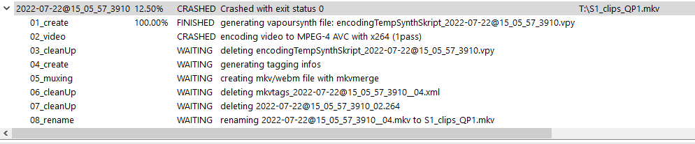

That's really odd. I followed those steps on creating a debug file, and now I did it again but the output TXT file is about the same. No idea what goes wrong here. Sad
[Image: attachment.php?aid=1821]
No, you changed the output folder,... wen enabling the debug output creation the HybridDebugOutput.txt is created inside the output folder, if you change the output folder, each time you get another HybridDebugOutput.txt.

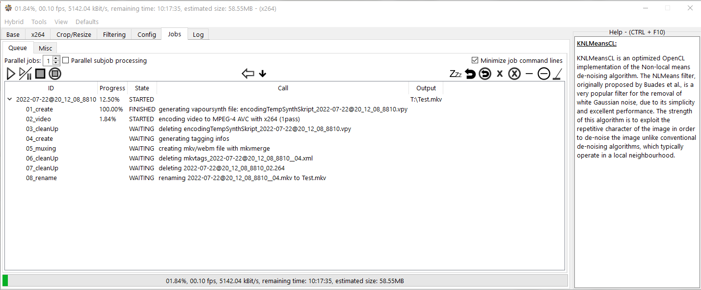

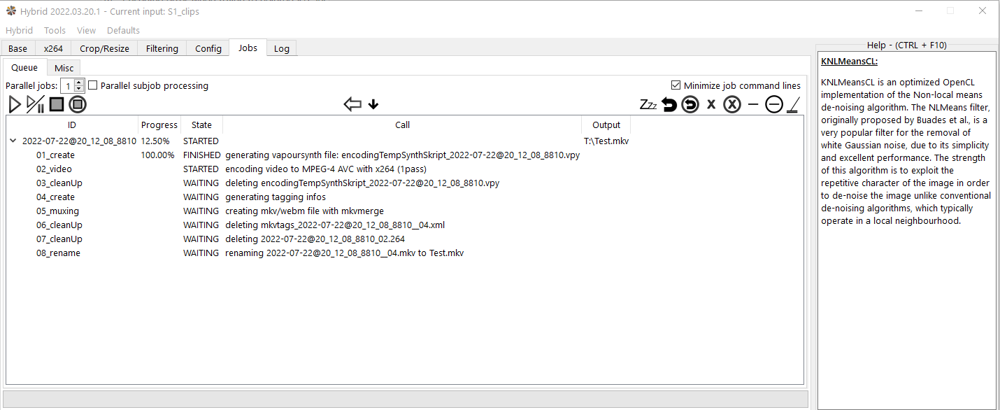

Okay, so it seems to be working now. I thought it was crashing but in a different way since it took almost five minutes till it would look different from this:
[Image: attachment.php?aid=1827]
10 minutes in:
[Image: attachment.php?aid=1826]
I guess this is quite an intense operation, at least for my PC. And it's just a 1 min 35 secs clip. I'm using a Intel i5-6500 CPU @ 3.20GHz and I don't have a GPU. But I'm switching to a AMD Ryzen 7 5700G 3.8 GHz soon, so maybe that'll improve the speed significantly. Still no GPU though.
