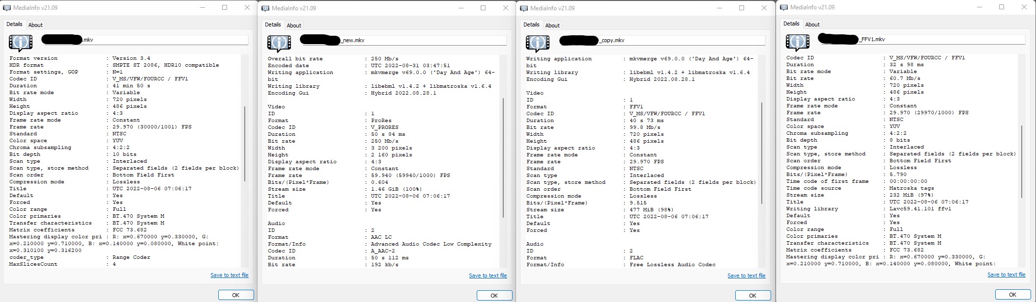

One last thing... When converting from my FFV1 master file to any other format (including just passing through), it appears to be losing it's metadata even though I have no advanced metadata selections set in Hybrid, etc. When converting to FFV1 8-bit, however, everything seems to be preserved.
I've attached an image of the metadata of four files. ".mkv" is the source file (FFV1 interlaced 10-bit), "_new.mkv" is processed QTGMC/progressive ProRes, "_copy.mkv" is simply with video & audio "passthru" selected in the "Base">"Processing" section of Hybrid, and "_FFV1.mkv" is the output converted to FFV1 8-bit with no other processing.
This can be replicated simply by passing thru a video with metadata (like the video I have given you in my previous link to you which should still be good). Let me know if you need more info like a debug log file.
Is this a bug? I feel like at least the color range and compression attributes (i.e. "coder_type" field) should be written to the output file if possible...
