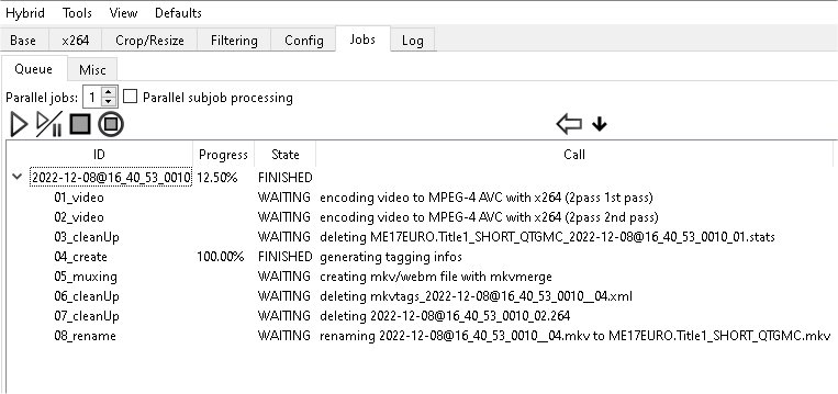

hybrid target output resolution and resolution created through the script to not matc
I get this error:
hybrid target output resolution and resolution created through the script to not match
Target: 720x480 vs script: 708x480
01: the audio is extracted.
02: here either the video job crashes (resulting in the above error), or keeps on waiting forever.
In Hybrid, I tried encoding with x264 and also with x265. Same error.
Picture crop on/off, same error.
At config-profiles, I did a reset all. Same error.
I encoded the source file with Handbrake to x265 and then used that file for Hybrid. Same error.
I have a 5 MByte source video file that reproduces the error, but the forum does not allow me to attach it... (also not as a rar file)

=> Atm. I can't reproduce the issue here. No clue what you configured to get the issue you got.

Then I do the following: turn on 'picture crop' and click on 'auto crop'
Auto crop gives this result:
Short clip - less than 100 seconds detected,...
  Analyzing the whole thing,...
   -> Crop result: 706:480:6:0, after 00:00:00.236hrs
And now if I do an encode, I get the error again.

  • Enabled "Crop/Resize->Base->Picture Crop".
  • Presser "Crop/Resize->Base->Picture Crop->Auto crop".
    and got: "Crop result: 706:480:6:0, after 00:00:00.161hrs"
And there the problem is: the crop and output resolution aren't adjusted! (both are still at 720x480, while they should be at 706x480.

Okay, good and bad news.
Good news: I found the issue and I think I fixed it. (also pressing auto crop a second time seems to fix it)
