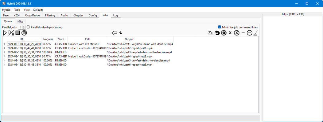

After trying those test jobs a few times, this was my best result when I tried running them all in parallel instead of sequentially. Sequentially they usually all failed:
![[Image: 1nSnw1724006879.png]](https://i.imghippo.com/files/1nSnw1724006879.png)
