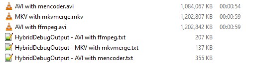

In the image attached/posted, the 3 output files seen are:
- AVI with mencoder.avi = shorter in size and duration than the other 2 files and than the original file
- MKV with mkvmerge.mkv
- AVI with ffmpeg.avi
