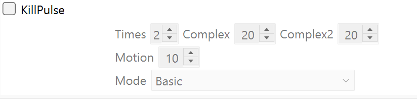

I'm wrote some code so that users could add filters/scripts to Hybrid. (in Avisynth&Vapoursynth)
The idea is, that a user could take for example Avisynths KillPulse and write a 'simple' xml file like:
<CustomScript name="KillPulse" version="0.0.1">

and Hybrid would add something like the attached image to the gui.
This would allow users to extend Hybrids filter support by their own, without really being able to program. Smile
Are there users interested in this? Would users share their xml files?
Theoretically, in the long run, the xml-structure might extend to support additional options and at some point most of the existing filters might be replaced with xml-files.

Hello! You may have already received a message about this but (at least in Hybrid 2024.01.12.1) tweaking settings for WDFPlus does not work correctly. Love the work, thank you!
[Image: C1Whikx.png]
Will look into it (probably tomorrow after work) and report back.
Had a quick look, and I think I fixed the issue. I forgot to set a default value for the optional 'useIndex' option which indicates that a list of parameters is used and their index is needed. So what happend, is that Hybrid thought the values were indexes and thus it added the uninitialized index offset. Wink
-> send you a link to a dev version for testing.
