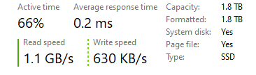

The rendering of the filter seems to be fairly quick once the file is loaded. But every time I refresh the preview it reads the entire file, which in this case is 74GB.
You are using LWLibavSource in software decoding mode. (which for SD content usually is faster than hardware decoding, but for UHD and higher resolutions you hardware decoding is usually faster)
I would recommand to either enable the hardware decoding (Filtering->Vapoursynth->Misc->Source->Libav hardware decoding mode) or use DGDecNV. Unlike LWLibavSource creates a physical index file once upon loading the file and then reuses this, LWLibavSource creates the index anew each time. Wink

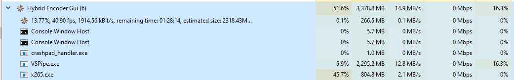

Going off topic from the original thread, but how do I make Hybrid use 100% CPU power? During this encode it's using ~50%.
Do I adjust --frame-threads and --pools from their defaults?
