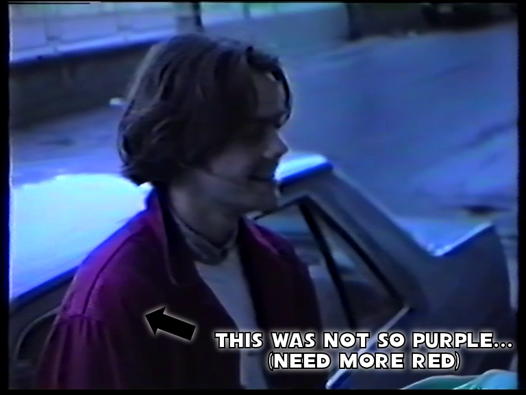

Can't find a filter or an effect to "reduce blue"
Probably i need to do this in post-processing with a video editor but i was hoping that can be done in Hybrid (i don't need to cut/edit this clip)
i have a VHS totally "blue" or "without" red ... probably a camcorder issue. or a wrong settings during recording (neon lights option)
this is a processed part using hybrid (deinterlaced, removegrain,crop,letterbox fillblackframes) http://www.wcn.it/wrongcolors.zip (MKV inside)
can be made some sort of script/code that can reduce the blue effect?

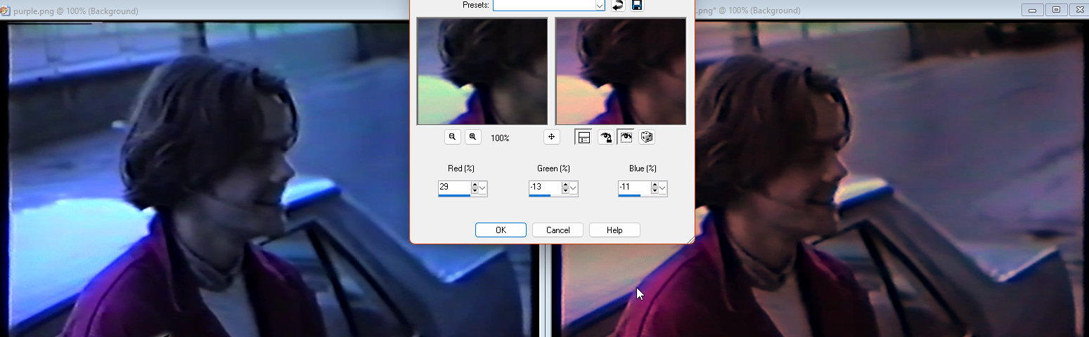

Grayworld, some LUT or Avisynths RGBAdjust might help.
Would need a small clip of the source to be give proper advice.

Instead of trying to manually adjust this (using RGBAdjust), look at:
Grayworld (median):
Grayworld (mean):
AutoWhite:
ColorYUV-AutoWhite-AutoGrain (Avisynth):
[Image: Avisynth-Color-YUV-Auto-White-Auto-Grain.png]
and then try to clean it up.
