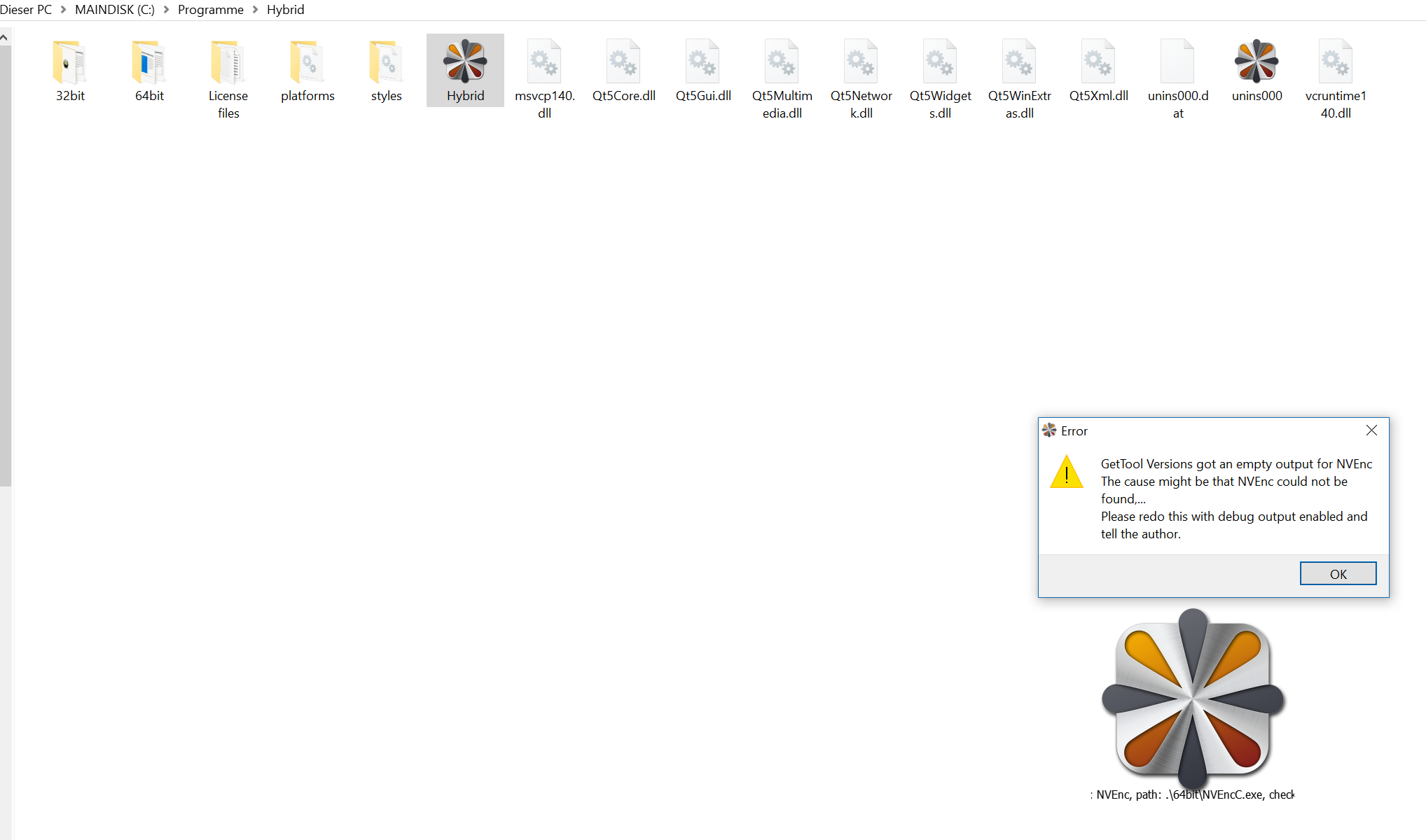

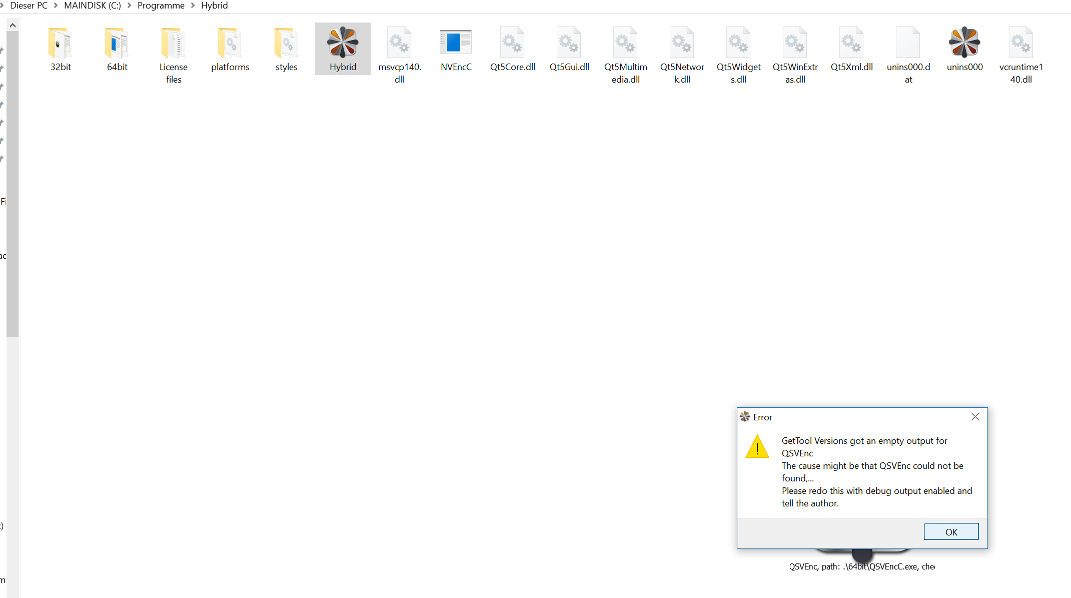

I uninstalled Hybrid and downloaded it again from Videohelp (if that makes any difference). And this time after installing it to the default directory I had to move NVEnc as well as QSVEnc but X264 encoding worked this time. I moved both exe files to the main Hybrid directory.
That's still a strange behaviour. Any way to fix to having to move the 2 exe files? I mean I'm fine now as long as X264 works but...

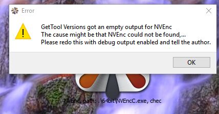

I attached 3 screenshots that were taken right after installing Hybrid again (in the order: NVEnc.png -> QSVEnc.png -> HS.png)
Edit: The problem with debugoutput is that when enabling that in Internals -> Create debug file, level while leaving those 2 exe files in the 64bit directory Hybrid will instantly close after the error message shown on picture NVEnc.png appears and there is no debug created (or I can't find it).

You should not have to move those two files. Will send you a link to my latest dev version today after work to see whether this also happens with the dev version.
At the moment it can happen that Hybrid doesn't detect all tools on the first start, but closing and restarting Hybrid should fix that.

I am Having the same issue with NVEnc at start up on version 2018.04.08.1 i completely remove the previous version includen the appdata info and still the problem persists. it wont even enter the program to check the logs.
#16
Are your drivers up-to-date?
