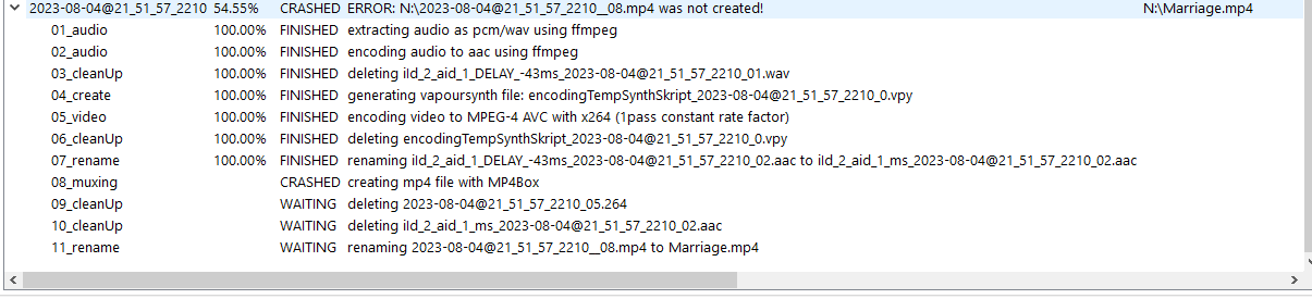

I got a CRASHED error because I ran out of hard drive space. It failed during the stage where the MOV (ProRes) and AAC were going to be muxed.
I found the MOV and AAC file in the temp folder. When I tried to import the MOV into Premiere, error said "We were unable to open the file on the disk". Also MOV file doesn't play in MPC or VLC.
Is there a way to mux these two files together in Hybrid? That is, assuming the MOV file is good, can I skip to 08_muxing step instead of restarting?
