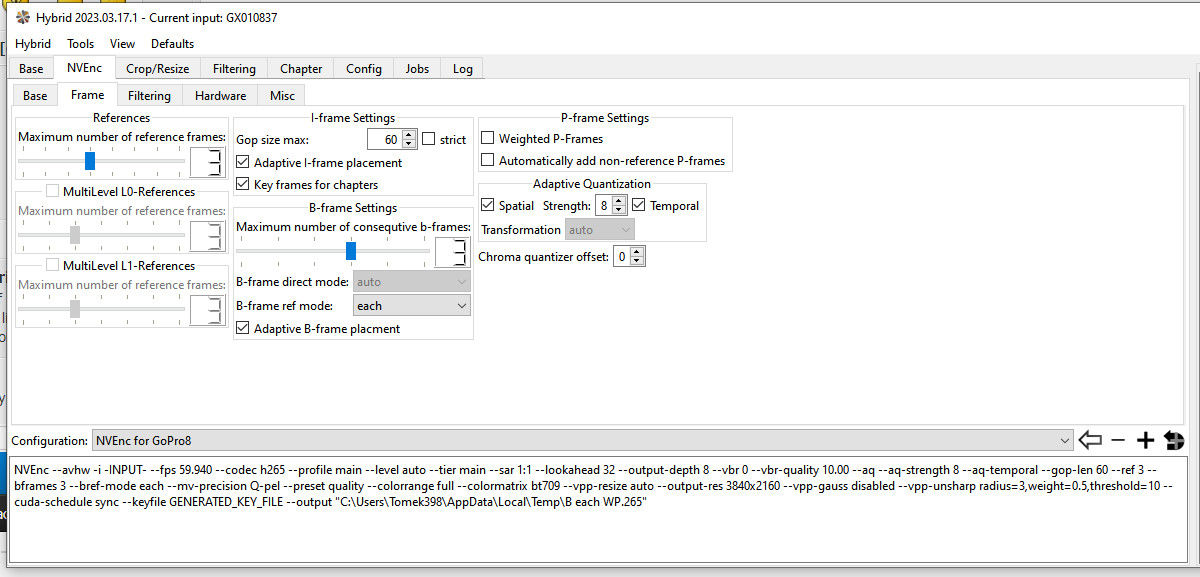

I try to understand various NVEnc setting available in Hybrid. Here are my questions:
  1. Weighted Prediction
I have found following info:
Quote:Weighted prediction is not supported if the encode session is configured with B frames.
Weighted prediction is not supported if DirectX 12 device is used.
https://docs.nvidia.com/video-technologi...index.html
I don't understand what means that "session is configured with B frames" if the context of Hybrid settings (my setting are attached)
I've noticed that I can select  /P-frame Settings/Weighted P-frames even is some setting for B-frames are also active. Does it mean that, when I use Weighted Prediction then B-frames are not enabled?
I also don't understand second statement about Direct X 12
  1. 2. I don't know if or when I should use B-frame ref mode: each/middle
Any help here would be welcomed.
The api can be accessed through different interfaces, since NVEncC does not use the DirectX interface can be ignored.
Regarding the weighted prediction of P-frames: I checked when B-frames are enabled, NVEncC will output:
weighted prediction with B frames unsupported.
So I'll adjust the gui to disable that option if b-frames are enabled. (I would recommend to use b-frames over weighted p-frames)
