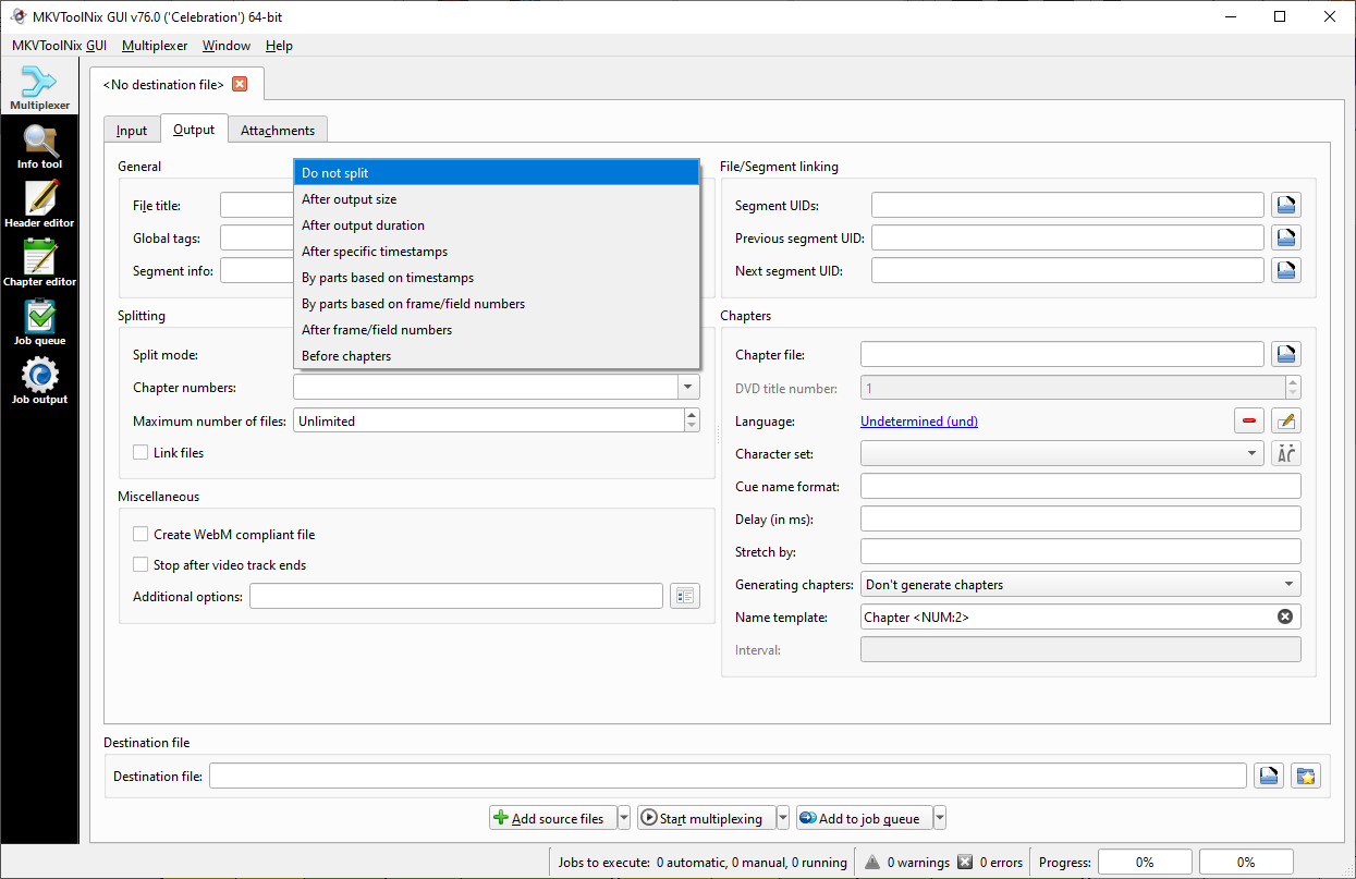

I Use MKVToolNix's splitting to split videos by chapters. it has others option for splitting.
Maybe you can use it.

1. multiplexing file without Video & Audio to a filename.mks file (a file with subtitle and chapters)
2. split filename.mks by 'all' "Before chapters Split mode" to filename-001.mks, filename-002.mks & ... (001 and 002 is chapter number)
3. Use filename-0xx.mks subtitle for number xx encoded chapter.
