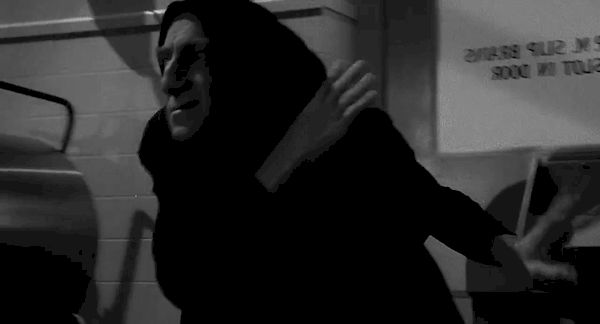

For example the B&W image of frame 899 of clip provided in my previous post is the following:
[Image: attachment.php?aid=2276]

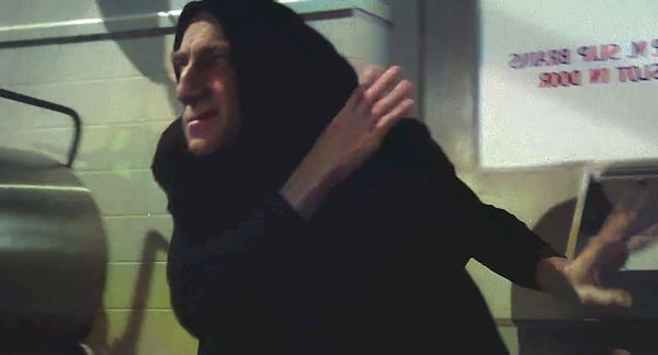

The image colored with Deoldify (default settings) is the following:
  [Image: attachment.php?aid=2277]

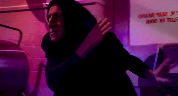

The colored image, is quite good, but the estimate provided by DDColor (default settings) is the following:
[Image: attachment.php?aid=2278]
which is quite bad. But applying the tweak: bright=0.2, gamma=3, the image becomes:
[Image: attachment.php?aid=2279]
which is quite good.
