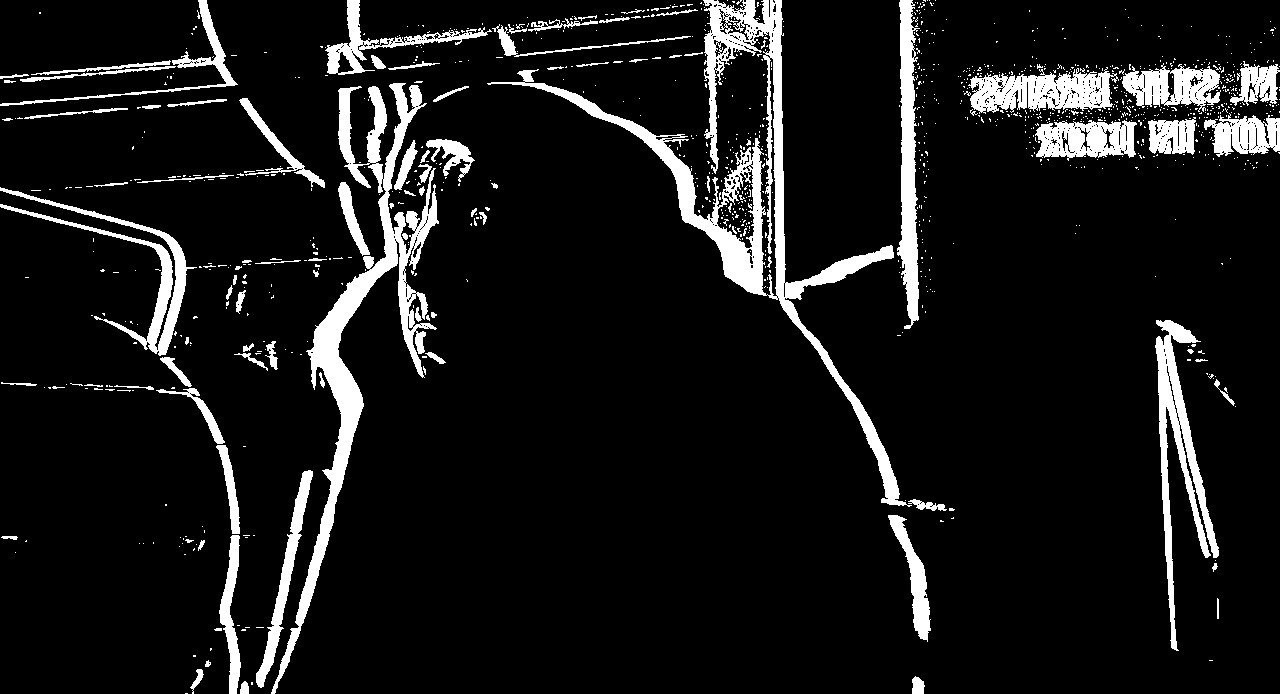

I confirm you, that this filter is flawd. As been written (or tested) to work in an narrow range of "tht=10"
Here the mask with tht=10:
[Image: attachment.php?aid=2318]
Here the inverted mask:
[Image: attachment.php?aid=2319]
If I increase "tht" the inverted mask becomes "white", this is not what I want. The expectation is that by increasing "tht" the moving parts will be considered "static", but the filter is unable to get this result.
Hmm,... I agree higher values should detect less changes.
