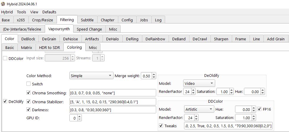

I noted a defect in the current version of Hybrid.
I can add more parameters in the list as shown in this screenshot
[Image: attachment.php?aid=2375]
But when I uncheck the filters are restored the old values
[Image: attachment.php?aid=2374]
Could you fix this issue ?
