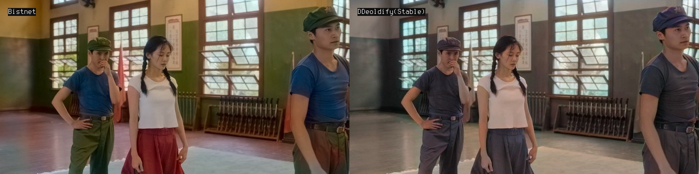

Here a simple comparison
1) Start frame (for Bistnet is an external reference image)
[Image: attachment.php?aid=2462]
In this case was used as reference the true starting frame, while DDeoldify had to guess, the colors.
2) Frame 25
[Image: attachment.php?aid=2463]
in this case (due to temporal consistency) the boy's pants on the right start to turn red (like the girl's skirt)
3) Frame 80
[Image: attachment.php?aid=2464]
in this case the boy's pants on the left start to turn red (like the girl's skirt)
4) Frame 125
[Image: attachment.php?aid=2465]
in this case the girl's skirt starts to turn green (like the girl's pants)
In summary is not so good, DDelodifi(Stable) colors are less rich but are more stable.
Moreover is very slow: only 0.15 fps
So probably more suited to fix some coloring lost using vhs transfers. (where you got just a few frames without colors)
