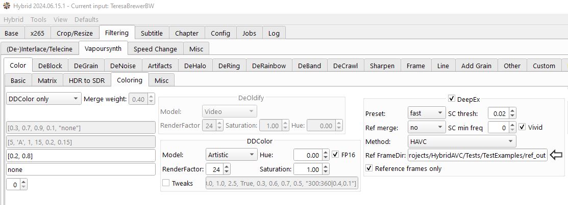

Your example is very difficult to colorize, your guess that the reference frames are generated too late is correct.
If you need to verify the generated reference frames you can used the following settings (threshold lowered to 0.02):
[Image: attachment.php?aid=2573]
there "ref_out" is the directory that will be used to export the reference frames. The generated video is not usable, this settings is useful only to extract the reference frames. Feel free to stop the encoding when will be generated enough reference frames.
With these settings you should find the frame: ref_000065.png
