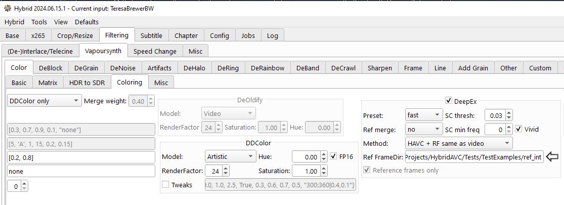

Your example is very difficult to colorize, your guess that the reference frames are generated too late is correct.
If you need to verify the generated reference frames you can used the following settings (threshold lowered to 0.02):
[Image: attachment.php?aid=2573]
there "ref_out" is the directory that will be used to export the reference frames. The generated video is not usable, this settings is useful only to extract the reference frames. Feel free to stop the encoding when will be generated enough reference frames.
With these settings you should find the frame: ref_000065.png
[Image: attachment.php?aid=2574]
Copy this frame in another directory, for example "ref_int" and rename the file in: ref_000001.png
Now you can encode the movie using the following settings (threshold increased to 0.03):
[Image: attachment.php?aid=2575]
In this way the file ref_000001.png will be added as reference frame n.1 and DeepEx will be able to start to colorize the next frames.
