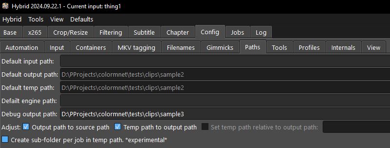

In meanwhile I discovered a bug regarding the debug output.
In my configuration I set to adjust the path with output folder, but this adjustment do not apply any more on debug output.
[Image: attachment.php?aid=2763]
As you can see I switched to path sample2 (I provided in input a clip stored in sample2), but the debug output was not updated (still the old path sample3).
Even worse, if I unset the debug output, the output file is not saved.
Please fix.
