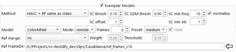

You need to set the method "HAVC + RF same as video" but in my opinion better results are obtained using "HAVC + RF different from video" as shown in the pictures below
[Image: attachment.php?aid=2843]
[Image: attachment.php?aid=2844]
(12.11.2024, 19:51)Dan64 Wrote: Hello Selur,
  I noted that you removed the flag "Reference Frames only".
  [Image: attachment.php?aid=2824]
  I know the reasons for the removal, but this flag is useful for a more advanced colouring process.
  I understand that this filter is quite complex to use, this complexity is also due to the fact that Hybrid is suitable mainly for advanced users.
  I'm planning to write a Colouring Guide for using HAVC in Hybrid to simplify the usage of this filter and reduce its complexity.
  Allowing people with no experience of Vapoursynth and Hybrid to use HAVC.
  In order to simplify the usage to people with little knowledge of Vapoursynth it will be very useful if you can introduce again in Hybrid the flag "Reference Frames only".
  This flag should be enabled when "Ref FrameDir" is set (not empty).
Hello Selur,
  in my previous post #773 I asked you the possibility to re-add the option "Reference frames only", but never answered to my post.
  I think that now there is a lot of room in the GUI for adding this option.
I also noted that once the field "Ref FrameDir" is set, there is not way to clear it (set it to null), could add this feature ?
