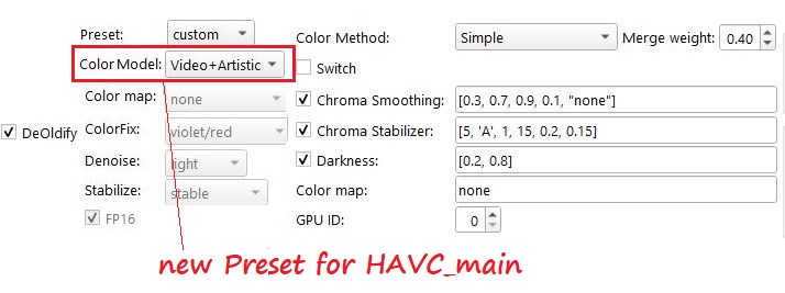

  The change requires to modify the Hybrid GUI to manage the new Preset: Color Model.
  Moreover is necessary to FIX the GUI as described in the following picture
  [Image: attachment.php?aid=2877]
.zip   vsdeoldify-4.6.5_RC1.zip (Size: 406,21 KB / Downloads: 219)
Uploaded an updated Hybrid_deoldify version for testing.
The section "Coloring" (recently introduced) it's Okay e don't have to be changed, please revert it as shown in the figure below:
 [Image: attachment.php?aid=2878]
What have to be changed is the column with parameters for HAVC_main as shown in the picture below:
[Image: attachment.php?aid=2879]
It is necessary to add a new Preset named: Color Model

Quote:I will not release the version 4.6.5
You can decide.
The new parameter ColorModel has impact only on the following custom sections (the last 2 has been added recently) : Color Method, DeOldify->Model, Coloring->Model, Coloring->Method
Here a snippet of code with the logic to change the custom section (I hope it 's clear)
ColorModel = ColorModel.lower()   if 'siggraph17' in ColorModel:     Coloring->Method=Alternative ; Coloring->Model='Siggraph 17' elif 'eccv16' in ColorModel:     Coloring->Method=Alternative ; Coloring->Model='ECC v16' elif 'modelscope' in ColorModel:     Coloring->Method=DDColor ; Coloring->Model='ModelScope' else:     Coloring->Method=DDColor ; Coloring->Model='Artistic' if 'deoldify' in ColorModel:     Color Method='DeOldify only' ; DeOldify->Model='Video' elif 'ddcolor' in ColorModel:     Color Method='DDColor only' elif 'zhang' in ColorModel:     Color Method='DDColor only' else:     Color Method='Simple' ; DeOldify->Model='Video'
