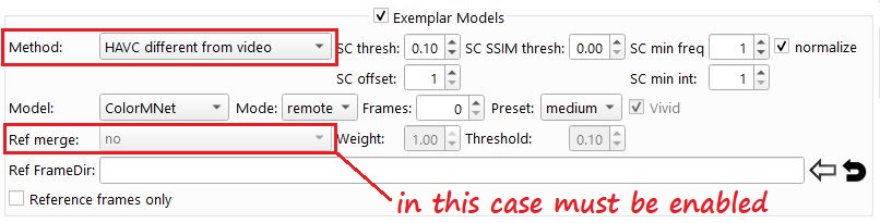

  Moreover is necessary to FIX the GUI as described in the following picture
  [Image: attachment.php?aid=2877]

The section "Coloring" (recently introduced) it's Okay e don't have to be changed, please revert it as shown in the figure below:
 [Image: attachment.php?aid=2878]
What have to be changed is the column with parameters for HAVC_main as shown in the picture below:
[Image: attachment.php?aid=2879]
It is necessary to add a new Preset named: Color Model
Uploaded an updated Hybrid_deoldify version for testing.
